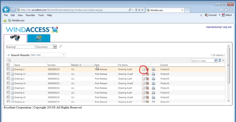

This is the exact reason we are planning to deploy WindAccess<.">http://eccellent.com/windaccess.asp>. We want to give our users instant, one-click access to all the additional published files right on a simplified search results page. Our implementation will have columns for STEP, DXF, IGES, and PDF (plus Creo View of course).

Feb 2, 2014 9:45 AM UTC
Dear All,
We have had this request many times, but for me the basic solution to the “too many clicks” problem is a new data utility e.g. configurable custom column, that gives fast access to specific data and can appear in the ootb search results. It is an easy and low cost of ownership extension if done right, after that you can move on to various extended search options if needed.
Something like this PDF example
Simon
