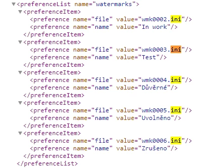

HelesicPetr
Sep 13, 2023 9:51 AM UTC
Hi @Amirtharaj_K
btw, your preference xml file does not contain configuration for ini files.
this is the reason why it does not work for you
example
PetrH

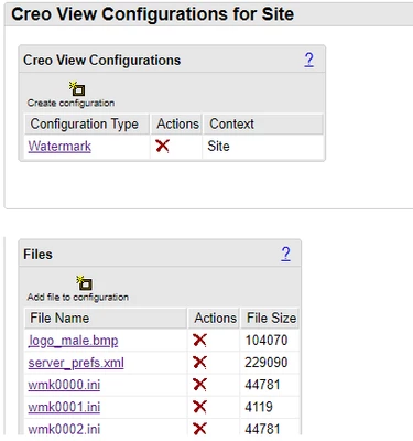

Sep 13, 2023 8:45 AM UTC
Thanks, Mr. Peter
I followed your steps and did everything, I got a watermark on the Server end. But if I open it in the User machine I can't see the watermark, After I added the ini file on that machine I could see it.
Please find the attachment.
Amir
HelesicPetr
Sep 13, 2023 8:51 AM UTC
Hi @Amirtharaj_K
Have you loaded the INI file in windchill?
also check the locked options for preferences.
https://www.ptc.com/en/support/article/CS32479?
PetrH
