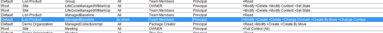

Here are the OOTB permissions regarding ManagedBaselines:
September 10, 2013
Thanks Lori, I don't have that entry in my Policies. That said, I think this problem is only a symptom of a bigger issue. I've raised a support call for it.
