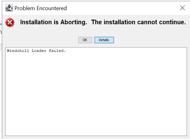

During installation PSI failed with " windchill Loader failed" and aborted the installation.
After further investigation it seems the Server manager Ubale to start the Method server showing timeout error.

FATAL 20-05-2024 07:23:52 - Windchill loader exited with error status = 1
DEBUG 20-05-2024 07:23:52 - Installation is Aborting. The installation cannot continue.

I had the same issue, and the solution proposed by PTC in those articles did not work for me. I ended up doing some reverse engineering to understand what was happening.
The root cause is that the timeout parameter is not taken into consideration. When the manual load is triggered, Windchill attempts to restart the application, which ultimately causes the load to fail.
The solution is to add the -NOSERVERSTOP option to the command line:
C:\ptc\Windchill_13.1\Windchill\bin\windchill.exe --java=C:\ptc\AmazonCorretto\jdk21.0.11_10\bin\java.exe --javaargs=-Dwt.load.installer.serverManagerTimeout=3000 wt.load.WindchillLoader -Application=Windchill.ProjectLink -Unattended -AbortOnError -Locale=en -User=username -Password=password -NOSERVERSTOP
After adding -NOSERVERSTOP, the load completed successfully in my environment. Hopefully this helps anyone facing the same issue.
