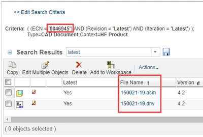

We have an interesting case where we perform 2 different attribute searches looking for CAD objects but the wildcard search shows less results than the non-wildcard search!
For example if we search by our ECN attribute:
ECN Attribute Search Number results Type  of results
0046945 2 asm and dwg
*46945 1 asm only
*46945* 2 asm and dwg
46945* 0 none, as expected

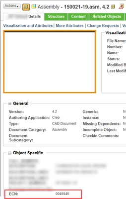

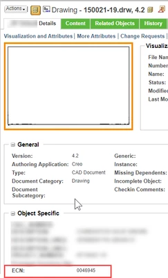

What does the detail information page show for that object in Windchill?
LawrenceS18-OpalAuthor
18-Opal
Mar 30, 2020 2:09 PM UTC
Yes, detail pages show the identical attribute value
  • asm
  • .drw
This is very bizarre.

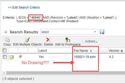

And here are screenshots of the 2 searches:
  • Complete attribute (no wildcard stars):
  • Partial attribute with wildcard star replacing missing text:
Again, between these 2 searches all I did was delete the 2 zeros and replace with a star, then made sure both searches used the same view (latest in this case...although I tried various views to make sure no filter buried inside one of the view's criteria themselves).
rleir17-PeridotAnswer
Mar 30, 2020 3:18 PM UTC
Hi Lawrence,
1/ with no asterisks, there is an implied trailing asterisk
2/ with a leading asterisk, there is no implied trailing asterisk
3/ both asterisks supplied
4/ the leading 00 is needed, as understood
The rules on implied asterisks are documented by PTC but I don't have a link handy for you.
The results you are seeing suggest that the DWG object's attribute has a trailing space or tab, but that is just a guess.
HTH -- Rick
18-Opal
Mar 31, 2020 6:57 PM UTC
@rleir, Well it looks like you are right and provided some very helpful supporting information for understanding what WC is doing!  I will add this to my table in the question body.  Thank you!
After your post I decided to open both model and dwg in Creo, and sure enough I found that the dwg had a trailing space!
It is very surprising that WC removes the trailing space from the attribute filed so that when I checked in the following ways it shows NO trailing space:
  • Search results:
    • Highlighted the entire field
    • Exported the search results to .csv or .txt
  • Detail page:
    • Highlighted the entire attribute filed text does not show a trailing zero
It is interesting that PTC chose to not display trailing spaces in WC, while still restricting the search.  I always liked the simplicity and consistency of attribute searches, but this seems a step backwards.
