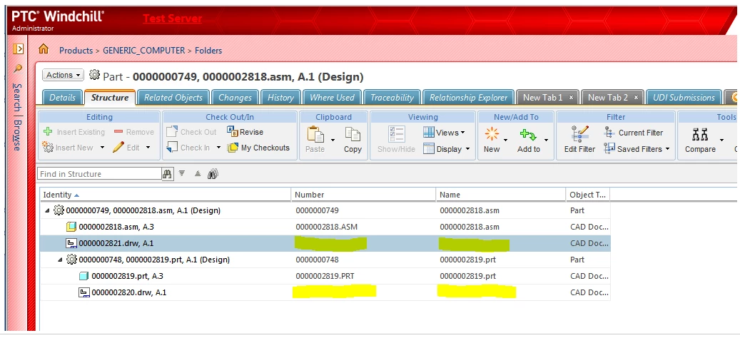

One way
Copy file similar to attached to
...\Windchill\codebase\netmarkets\themes\windchill\Header
[cid:image001.png@01CF952A.6EA3B020]
[cid:image002.png@01CF952A.6EA3B020]
[cid:image003.png@01CF952A.6EA3B020]
We do this to identify production training, test, etc.

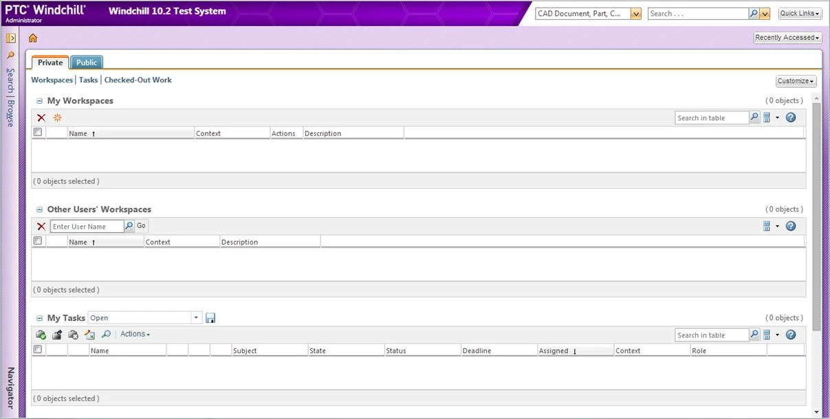

[cid:image006.jpg@01CF9547.E418C940]
Tom U.

So Tom, instead of editing any CSS etc, you just edited the actual stock images themselves using the IrFanView graphics editor. Correct?
It definitely looks nice 🙂
[cid:image001.gif@01CF7046.C96AB930]
