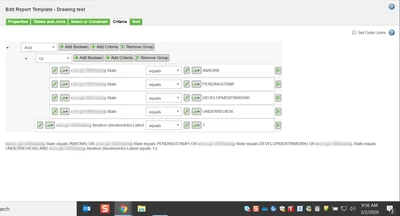

Mar 2, 2020 3:00 PM UTC
On the Criteria tab, if you add a criteria that <business object>.State equals Released, that will pull in only released objects.  In addition, if you set the criteria <business object> (iterationInfo).Latest to "Yes," that will return only the latest iteration.
I am building a report that looks for several states, but excludes released and those like it.

Mar 13, 2020 4:48 PM UTC
This sounds like this method will show all the latest of every revision.  Is that correct?
Mar 13, 2020 4:56 PM UTC
That is correct; given that the lastest meets your lifecycle state criteria.  In my case; I am excluding released, so if my Rev A is released and my Rev B is in work, I pull back the latest non-released version.
