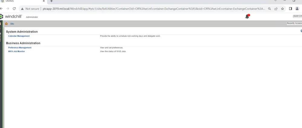

I am using Windchill PDMLink Release 11.2 and Datecode with CPS 11.2.1.17
After update of release to 11.2.1.17 wcadmin (Administrator) is no longer active. All other users are working right but wcadmin no. I can't publish cad document in this way

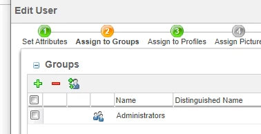

    This is workaround
    Log in as a wcadmin
    go to administrators on the site you should see this
    go to the wcadmin user detail page
    use Actions and edit the user,
    remove them from all groups and profiles

    9-Granite
    Sep 13, 2023 8:14 AM UTC
    HelesicPetr
    Sep 13, 2023 8:16 AM UTC
    Hi @FC_9723361
    This is problem with disabled profiles, remove the admin from all groups
    then you'll see all be fine.
    Exclusion group usually is added to others license groups that uses disabled profiles, and the disabled profiles case this behavior.
