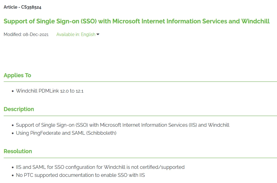

It looks like single sign-on with IIS is not officially supported, so you're probably on your own.
https://www.ptc.com/en/support/article/cs358524

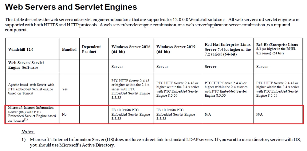

Windchill has been supported on IIS for quite a long time.  No idea about single sign on though...
From the Windchill 12.0 support matrix:
