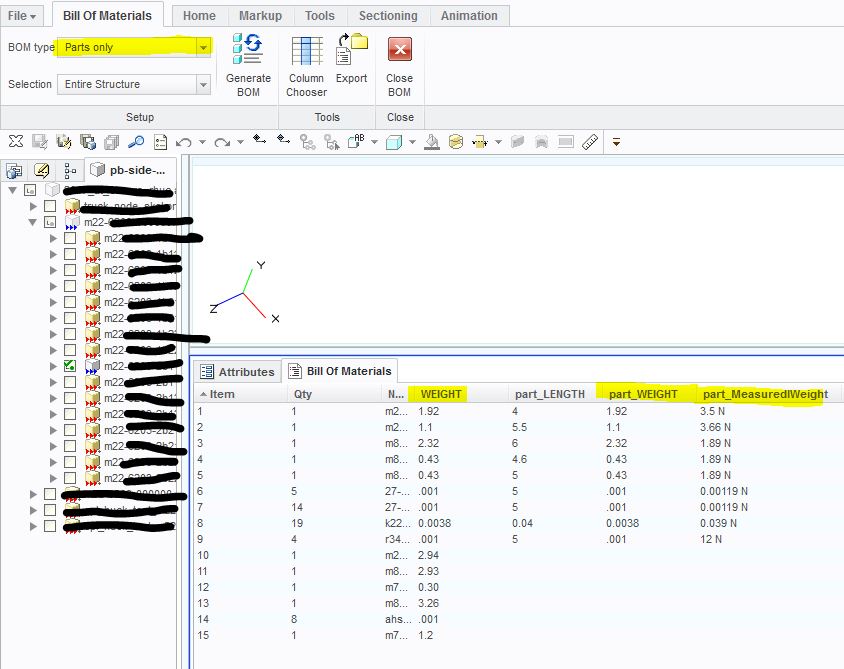

My use case is probably unique and not proven out yet...but a concept I'm working on that involves Creo View bill of material functionality.  Creo View can export a BOM of the ".prt" CAD type files only...this might eliminate the need to worry about assemblies.  The image shows a WTPart structure assembly...Creo View can output any attribute from Parametric, Windchill or WTPart (Part_Weight) and (Part_measuredweight) as highlighted.    The nice benefit about Creo View is that we can load the file at any time and with positioning assembly structure it loads the latest version of the lower level components  Creo View Bill of Material only outputs the files that are loaded...most of the structure below is not loaded.  So theoretically in my case, an engineer in Europe can update the weight of the CAD engine block and I can open the top level truck assembly from North America in Creo View and automatically get the change very quickly after he checks it in. You will notice in the image below that there are multiple m22 assemlbies...this is what we call an overloaded assembly as it represents multiple options.

This is an interesting approche, but requires CreoView MCAD.
Can you write back the values to the object attributes?
So they can later on be used in / transfered to an ERP system?
