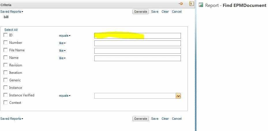

David, We have a "Report" set up in our Windchill enabling us to find the "EPM Document" based on the ID Number. See attached picture. Does the CAD object file name of the ID number match the CAD file name the user is adding to the workspace? Here are a few things that come to mind as possible solutions/issues.
1) Clear the user's cache information on the server.
2) Check to see if the user has a partially lockedinstancein the active workspace or even in another workspace, (ie generic.prt, instance1.prt, with instance2.prt locked) This will wreak havoc with Windchill/Creo Communication.
3) Make sure all the instances reside in the same home(folder) as the generic.
4) Does the user havevery many new objectsin theworkspace? There is a config.pro setting that drives the "copy drawing" checkbox when copying assemblies or parts in a Creo Session in a save as operation. We had all kinds of issues with this setting when theuser would copy a large assembly...because in our environmentthe required dependents were not in the worksapce. A bunch of ghost files with same name exists get generated because the "new" drawing wants all the dependents.

If you could identify an EPD Doc that cannot be added to Workspace, you
could select Actions, Manage Security and explore the security setting for
different users. I think I have a query builder report that might provide
the Number of the EPM document based on what looks like its object id. Let
me know if you need it.
