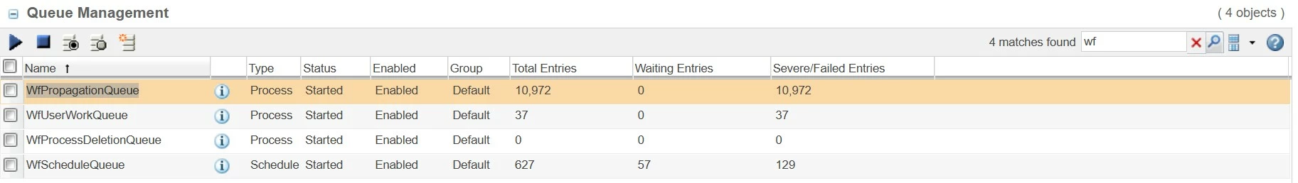

Use Case: WfPropagationQueue severe entries.
Description:
I am working as an Admin. i see there are 10000+ severe/failed entries in the WfPropagationQueue.
is this concerning? what should be the normal value and how to keep the Queues healthy? please help me understand if any procedure i need to follow. see snap attached.
Release: 12.0.2.7
thanks
Sandeep

23-Emerald II
Jun 10, 2025 1:21 PM UTC
you can delete , any entry needed will  be recreated

Fadel
23-Emerald II
Jun 2, 2025 1:24 PM UTC
severe and failed entries can be deleted with no concern they will be recreated , as you have +10000 entries , you may use the utility to reset them in bulk  : https://www.ptc.com/en/support/article/CS134506

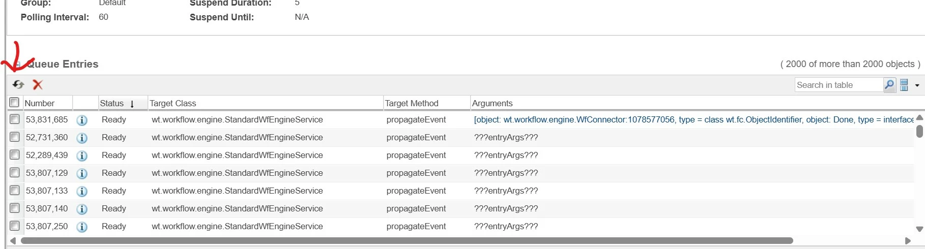

sandy0078-GravelAuthor
8-Gravel
Jun 6, 2025 7:06 AM UTC
Hi @Fadel ,
thanks for your response. i see an option here to reset them see snap Queue_1.jpg
i have reset the Queues from there but still the number didn't reduced.
Br,
Sandeep
Fadel
23-Emerald II
Jun 10, 2025 12:45 PM UTC
Thanks , I see now that the entries are in ready state , however it seems there is an issue with argument :
try to run the tool again and this time delete entries instead of reset .
