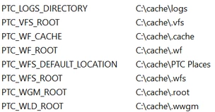

I found it necessary to explicitly set all the environment variables to someplace that is definitely not shared because everything would default to a OneDrive location if left to it's own devices.
PTC_WFS_DEFAULT_LOCATION sets the "PTC Places" location (although perhaps this is 12+ versions according to CS353857 ?) for your Windchill Folder Full Path.
AutoCAD, I don't think, needs all of those set.
If the WFS is consistently not starting up, it could also be an issue with the installation where you'd have to manually install just the Creo agent.
If you have any startup scripts for task kill, it may also help launch fresh every time.
