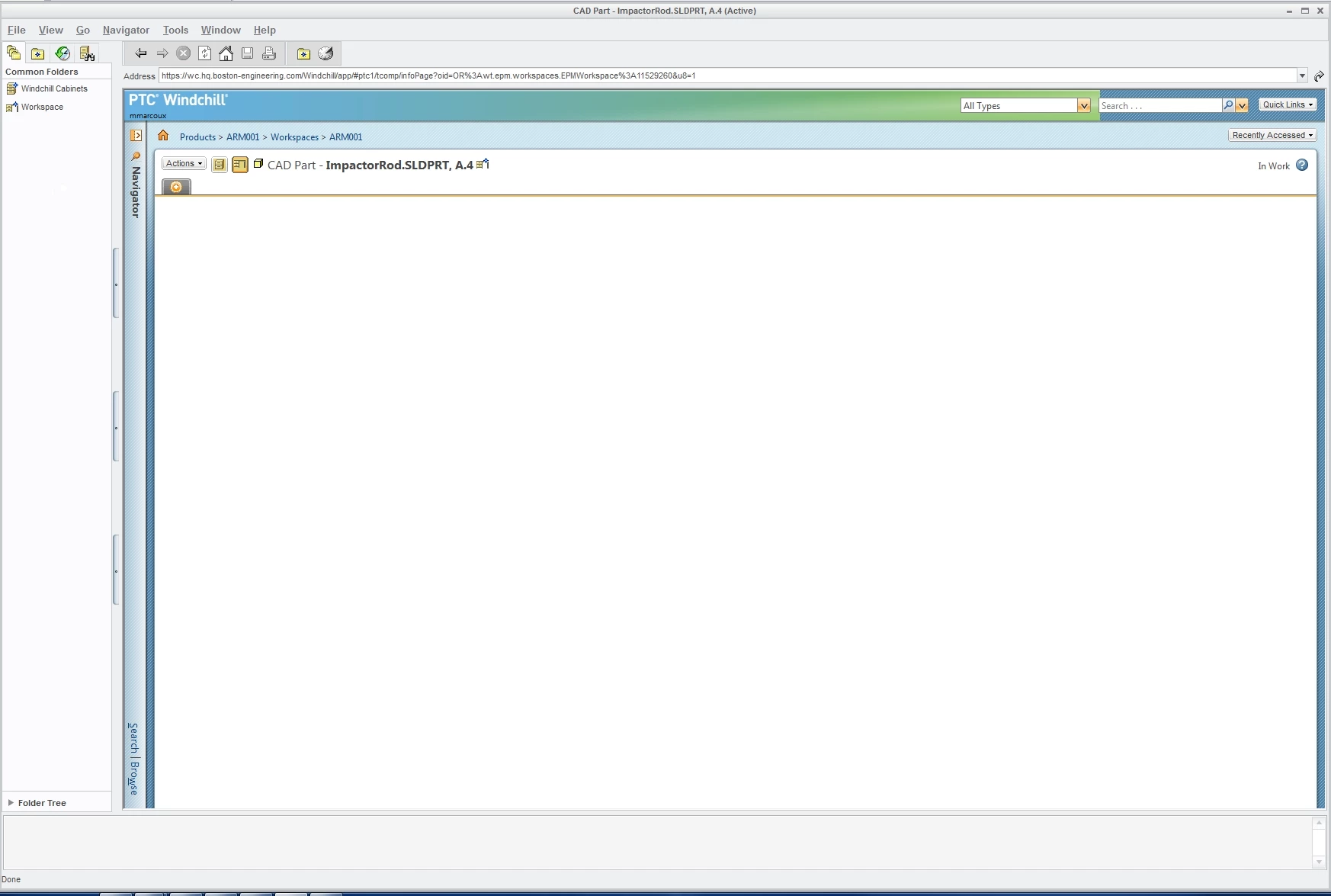

Running 10.2 M020 with SW2013/2014. We've notice an issue that the "view information" page load blank for any content, commonspace or workspace. Literally loads a blank page. Can still access actions, but can't see anything. Thoughts?

Changing the .ini file to point to IE and adding a certificate exception for our Windchill address in the browser has fixed the problem.

Does this only happen through the embedded browser? If you open up Windchill in a standalone browser, are you able to load the view information page?

Hi Chris,
Yes, it only happens in the embedded browser. When looking through Firefox/IE, everything looks fine.

Since there is a known issue similar to this with the embedded browser in Creo2 (WC 10.1), try this: Grab the divider between the navigation pane and the content pane and resize the pane or resize the entire window. Does this cause the contents to appear?
