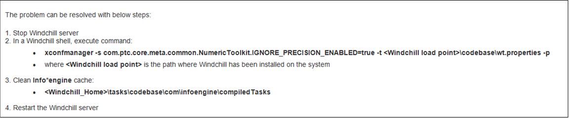

We currently use PDMLink  M050 with WGM for CV5 R19, we made a mapping between CV5 attibutes for mass, volume, surface area and for creation CV5 documents, the values are truncated in the PDMLink workspace only for new CV5 documents after update of PDMLink mapping, Is anyone faced this kind of issue?
0.874               => 0.00000000000
6.78e-003        => 6.00000000000

Hello all,
To solve the issue, we follow PTC solution:

Did the solution help you? if not you should have a look at Re: Unable to show any component costs that are less than $0.01 . There are some issues in this which is fixed in 10.2

Hello Binseh,
The solution deliver by PTC (see my additionnal comment after issue descrption) solved the issue.
