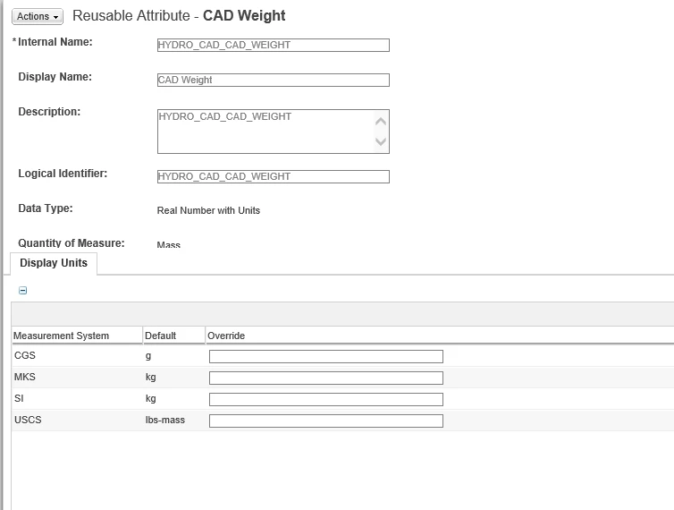

using Windchill 11.0 M030 CPS16 and Solidworks 2019 SP4, I would like to map mass properties from CAD to Windchill. Following the documentation found here: https://www.ptc.com/de/support/article/cs258281
I created a global attribute as a real number with units:

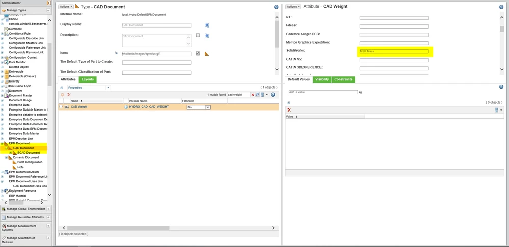

added, the attribute to EPM CAD Document and mapped the attribute to MSP:Mass:

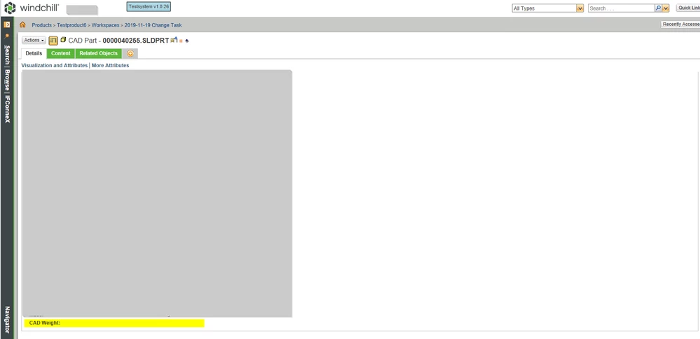

However, mass properties are not shown on the CAD Documents details page:
What am I doing wrong?

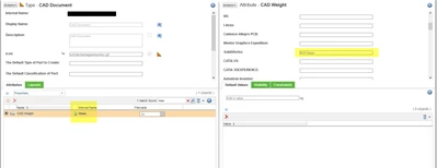

Solution found:
The mapping of Solidworks parameters with units only works if the internal names of the attributes are identical to parameter name in Solidworks. So to map the mass, the internal name of the attribut in Windchill must be mass.
