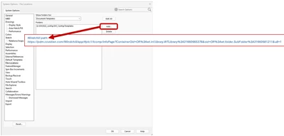

WGM Solidworks windchill template locations
SW2022 SP5 -WGM 13.0.1.0 and Windchill  Release: 12.0.2.23
how do/can I map Windchill template folder path in Solidworks ?
Windchill path is a url path ?
our creo9 path is defined as:
template_solidpart wtpub://pdm.covidien.com/Libraries/CADStandards/Templates/MNav/startpart__mm.prt
thanks
Rich

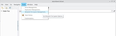

Hi @rburk you will be having a windchill file system location set on your machine, it's a virtual folder,
You can find it's location from Windchill Workgroup Manager> Tools > Windchill file system management
Browser to this Virtual folder from solidworks- PTC places/Commonspace/<your template folder>
This should set the location for the templates
Hope this helps!

rburk13-AquamarineAuthor
Dec 22, 2025 5:59 PM UTC
 found the path, thanks
working now
