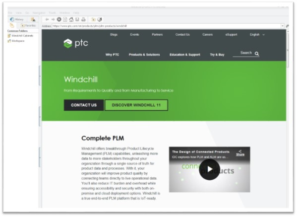

Greetings.
I have a User who is asking me if there is a way to shut off the splash screen and have WGM open directly to his Workspace?  We are using WGM for Inventor.  I suspect there isn't but thought this group might have a way.
Current View: Current starting view_

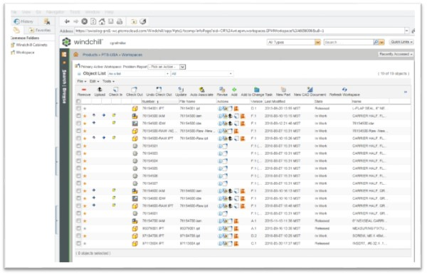

Desired starting view:
Desired View_
Thanks in advance,
