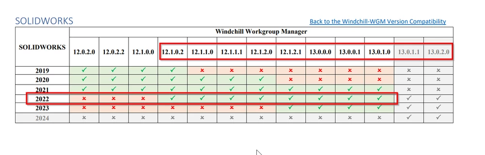

Hi Eliran,
The below image for PTC official post WWGM compatibility software matrix, and it will work highlighted series only
https://www.ptc.com/support/-/media/support/refdocs/Windchill_PDMLink/compatibility/WWGMCompatibilityMatrix.pdf?sc_lang=en&source=search
let me know , if any further help required
