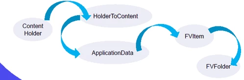

Great explanation. so, there must be a communication between Vaults and Database if incase user tries to access any document, it should also pull the info like meta data that is stored in Database and actual file from vaults simultaneously.
what would be the common point that it pulls the right info from both parties when user tries to check out a drawing?
avillanueva
23-Emerald II
Dec 7, 2022 1:51 PM UTC
 Yes, Windchill has tables in the database which it uses to track where the files are in the vault. Its complicated but if you looked at the vaults, you would not recognize anything as they filenames are just a HEX hash. The image below gives you a sense of table structure and complexity on the database side to keep track of what files below to what object. Remember that your not checking out files, you are checking out objects, whether that object is a CAD Document or a WTDocument. Each of those have content and are content holders. Their related attachments and primary files are what goes into the vaults.
This structure allows for more complicated setups like remote cache vaults for distance sites far from the main Database. This is necessary since it takes less time to transmit meta data rather than large, binary files like CAD data across a WAN.
