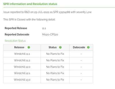

Jun 29, 2023 12:42 PM UTC
Global attribute are bugged, you can't search based on them and PTC don't plan to fix this.
Don't base your PLM architecture on that :
https://www.ptc.com/en/support/article/CS373513?source=search

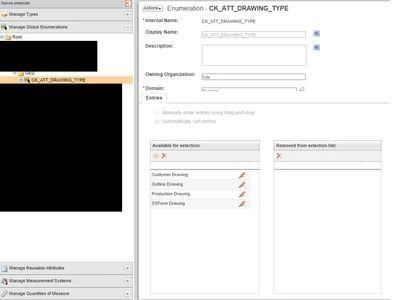

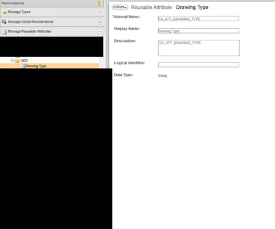

Attribute type created as reusable attribute
enumeration used by the attribute

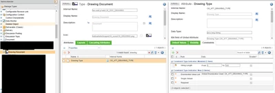

the attribute definition on the doc type :

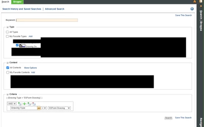

The search that give 51 results :
A report provide more than 1700 document with this value.
