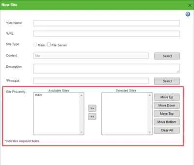

Here is an excerpt from the Windchill Help Center:
When creating or editing a site, you can set a list of sites in order of proximity to the new or updated site. During ad hoc replication, the system checks these sites in the order they appear in the list to determine which site the content should be retrieved from. By setting up the site proximity list, you can ensure that user requests are fulfilled as quickly as possible by using the closest site. By default, the main site is added to the end of the list, if it has not already been included in the list in another place in the order.
You can implement it in the New Site creation under File Server Administrator as shown below.

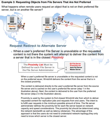

Dec 2, 2022 12:29 PM UTC
The answer to your query is there in the links shared by @avillanueva . Pasting an extract from the second link. let me know if this answers your questions.
