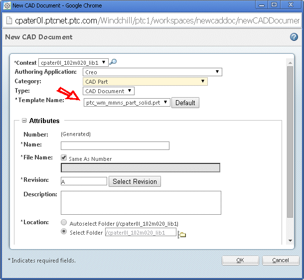

hi everyone!!!
i am using the windchill 10.2, still i didn't understand the use of "new CAD Document" option which is availble in workspace. when i click on this option i am create new cad document which didn't have any model.

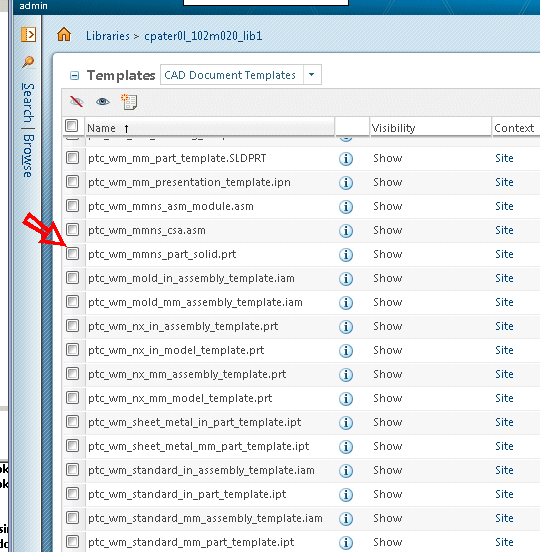

The New CAD Document UI is populated with Authoring Applications/Categories/Types/Templates based on CAD Document Templates that exist:
You'll want to check that you have the OOTB template CAD Docs or create some new template CAD Docs from existing models.
