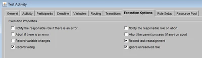

What is the use of Record Variable Changes property in Workflow?
Fadel
23-Emerald II
Oct 3, 2025 3:46 PM UTC
Record variable changes Saves the variable values entered by an individual assignee in the activity.
This applies only to variables that are displayed in an activity and are editable by an assignee for the activity.
These values are captured during workflow execution for each activity instance and for every time the activity is executed

Let’s say I have an activity with a workflow variable called Special Instructions.
I also have a notification robot that uses the value of this Special Instructions variable.
The activity is configured with Record Variable Changes, which saves the variable values entered individually by each assignee.
In this scenario, Which value will the notification robot use for Special Instructions?
