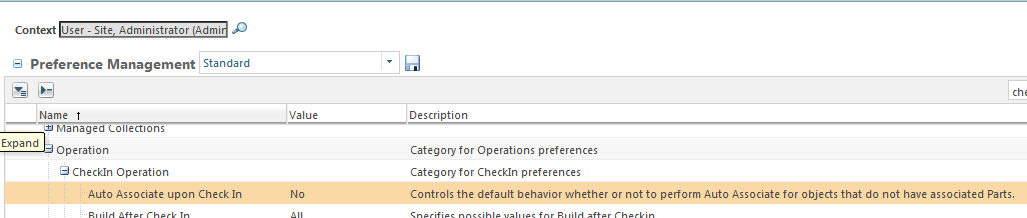

To disable Auto Associate, open Windchill Preferences, Operations and then CheckIn Operations.
Set Auto Associate upon Check In to NO
This can be set at the context level or user level which will override the context level.
Check to see who created the WTparts, as it may be a user who set their preferences.

Thanks Ben, I will have to ask our IT how to get to this. I can't find it when I log in to Orgadmin.
