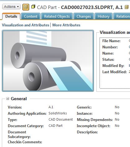

CAD Document = CAD Part, CAD Product, CAD Drawing etc.
No preview picture because test-server doesn´t run the needed converter
CAD Documents can be linked to WTParts:

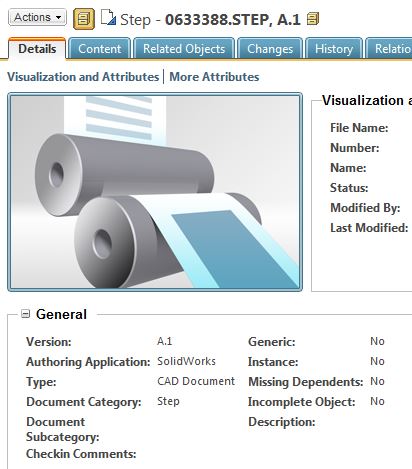

STEP file uploaded with SolidWorks:
Preview picture also not created on Live-Server
tbauer1-VisitorAuthor
Apr 4, 2014 6:07 AM UTC
I´m not sure what software you mean.
See Tags: Software is Windchill 10.2 with workgroup manager.
See general attributes of the parts: Authoring Application of the uploaded parts is SolidWorks (2013).
I hope this information was what you were asking for.
