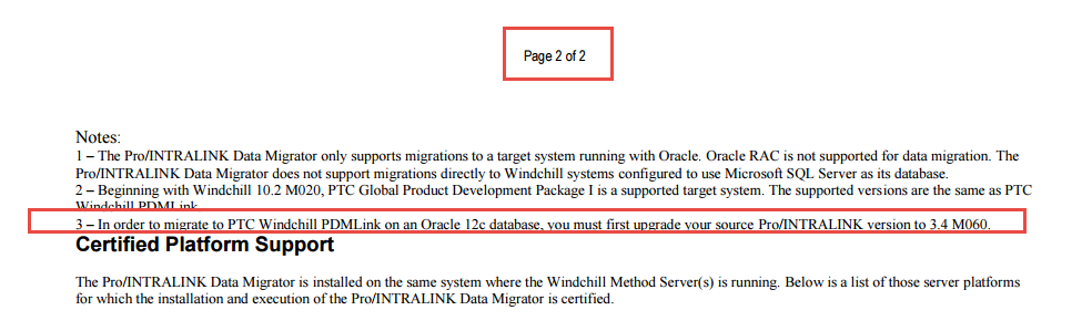

Apr 13, 2016 4:26 PM UTC
Thanks Binesh,
I followed the link but it does not mention Source System 3.4 M060? It seems to indicate any version F000+
2-Explorer
Apr 13, 2016 5:20 PM UTC
Hello Robert,
Here it is
Regards
Binesh Kumar
