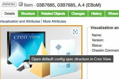

Use Case: When creating a CAD object and checking in to create a associated PART with owner links, sometimes (not always) the CAD object gets a visualisation OK but the PART is not visualising, instead it has a "open default config spec in creo view" instead of the 3D visual.

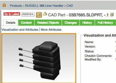

  2. the CAD object triggers a visualisation job and creates ok
  3. the PART doesn't trigger a job and is listing no thumbnail or visual
  4. the PART has "open default config spec in creo view" instead and the content tab just list the structure

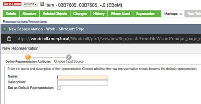

  5. If you goto the PART and try to republish - it has a different wizard and settings

the PART with owner association

The representation from the non-latest CAD object (shown above) probably isn't going to update the representation for the latest version of the WTPart.  When you look at the 'CAD/Dynamic Documents' section of the WTPart's 'Related Objects' tab, what version of the CAD object does it show the owner link to?  Is it the -.1 version of the CAD part, or something later?
