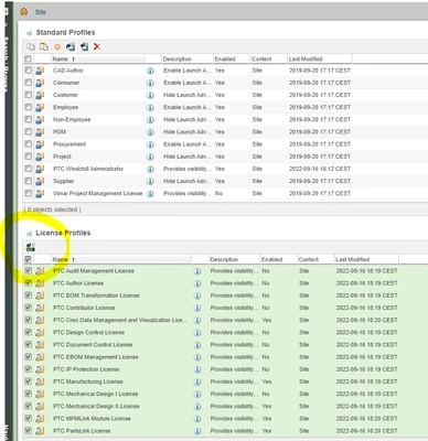

MarcoTosin
Mar 1, 2023 1:36 PM UTC
You can check whether the problem is actually due to a licensing profile, which limits the actions available to the user, by exporting from Windchill an Excel file showing all the actions available for each licensing profile in the system.
From license profiles select the ones you want to verify and export to Excel with the appropriate button
See attached Excel
Marco

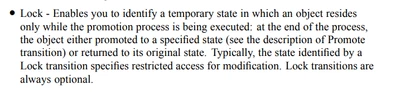

jbailey
18-Opal
Mar 9, 2023 3:11 PM UTC
Are there lock transitions in the lifecycle for these states?
