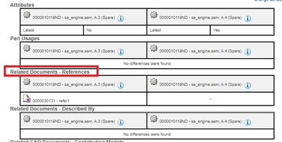

When comparing 2 WTDocument Versions/Iterations, there is no option to choose "Referenced By Parts"
I am using Windchill PDMLink Release 11.1 and Datecode with CPS M020-CPS16
When comparing 2 WTDocument Versions/Iterations, there is no option to choose "Referenced By Parts" as the criteria for comparison.

    Hello @Vijayachandra
    No there is not that option.
    The reason is that a reference WTPart iteration is connected to master of Reference document so all iterations and revisions of Reference Document.
    Only the latest reference document is shown on the WTPart. There is a rule that the released version of document should be shown on the WTPart.
    Only from WTPart perspective you can compare referenced document in history of WTPart.
    If you compare two different documents that could have been that option, but it isn't.
    Hope this could be more clear.
