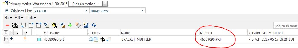

When creating a new CAD document in creo, how can I change Windchill settings where the number does not have .prt appended?
  • May 17, 2015
  • 1125 views
When creating a new CAD document in creo, how can I change Windchill settings so the number field does not auto populate where .prt is not appended?
Per below example: I created a new creo CAD file, file name is 46689090.prt.
But the number field will append the .prt to it, how can I make it come in with the just the 8-digit number?
Best answer by kpritchard
Try Preferences... "Upload Drop Number File Extension" set to Yes.
You may run into issues if you have not Soft-Typed your Drawings and use a model number = drawing number convention, as the Number must be unique within a Type. models (prt & asm) as well as Drawings (drw) are all CAD Documents (same type) so the Number must be unique.
