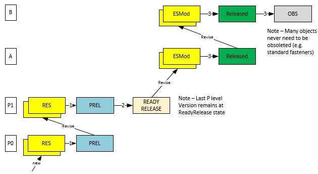

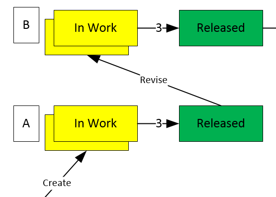

A diagram explaining your lifecycle and transitions is critical for planning, configuring, testing, user training, etc.  We came up with an enhancement to the diagram that has been very helpful to both the admin team and users.  Key is to use a row for each Revision in addition to showing the states.  Then, the arrows become either within a given Revision or between Revisions.  The difference for Revise (and the state change which happens) becomes clear immediately.
Color coding helps.  In this diagram, users can Check Out / Check In only at the yellow state and the company "does business" only at the green state. In this diagram the "stacked" yellow blocks indicate Iterations from Check Out / Check In.  Color coding the states also helps in planning and explaining the different watermarks applied (Creo View) dynamically by state.
The Number 3 above relates to text elsewhere on the diagram that explains the Change process in detail.  When these transitions are done using Windchill change management, Revise and Check Out / Check In are done during Change Tasks (on the Change Task object).  The state change to released (3 above) is due to a Change Notice robot action.  Promotion is not used here but if used, would be noted by a number on an arrow.

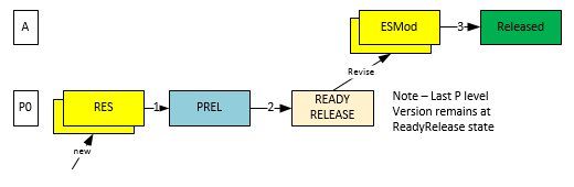

Note: We use a relatively complex state-based versioning two-phase lifecycle for most product data (not too different from the PTC example diagram above).  This approach to the diagram helps even more for this situation, especially because Revise is the transition from numbered to lettered Revisions as well as to the next Number Revision.  Here is that diagram, two variations.
MINIMUM TRANSITIONS
TYPICAL TRANSITIONS
