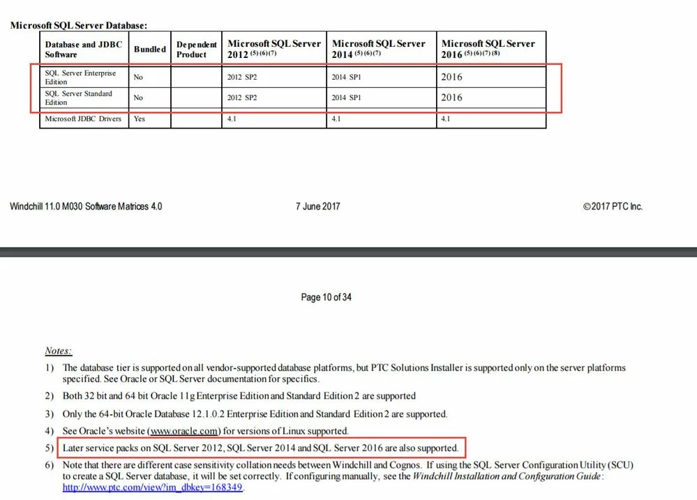

We are working on getting a server spec'd out to go from 10.1 M050 to 11.0 M030.
The document CS254192 on PTC's site states "Windchill PDMLink 11.0 M030 will not be supported with Microsoft Windows Server 2016" but nothing at all about when it WILL be supported.
Does anyone know when 2016 will be supported?

Apparently some of the 3rd party software Windchill relies on is not compatible with Windows Server 2016.  Until it becomes compatible, Windchill can't make the jump.  (No, I don't know which pieces.)

Something is wrong with that case solution. If you refer to the software matrices,  2016 is supported.platformsupport.jpg
STEVEG21-Topaz IAuthor
Jun 30, 2017 2:17 PM UTC
I mean the OS.  Not SQL.
2-Explorer
Jun 30, 2017 2:21 PM UTC
my bad...sorry! I am used to MS abbrevation with SQL Server, but not with Windows Server.
