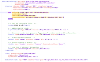

When windchill integrates the installation of Shibboleth, an abnormal configuration of the shibbolet
I am using Windchill MPMLink Release 12.0 and Datecode with CPS 12.0.0.1
When windchill integrates the installation of Shibboleth, an abnormal configuration of the shibboleth2.xml file is reported. How to configure it?
Here are the errors that I faced
shibsp::ConfigurationException The system encountered an error at Mon Aug 26 20:45:27 2024 To report this problem, please contact the site administrator at root@localhost. Please include the following message in any email: shibsp::ConfigurationException at (http://test.olightcloud.com/Windchill/Login) None of the configured SessionInitiators handled the request.

    I tried it, but it still doesn’t work. Mine is a Windows system.

    There is likely something wrong in one of the <Sessions> attributes or SSO sub element.
    Have you used the SAML tracer plugin to try and see what the root issue is?
    Aug 30, 2024 1:59 AM UTC
    I have used the SAML tracker plug-in to view the logs, but there is no information. This is my configuration. Is there something wrong with the configuration?
