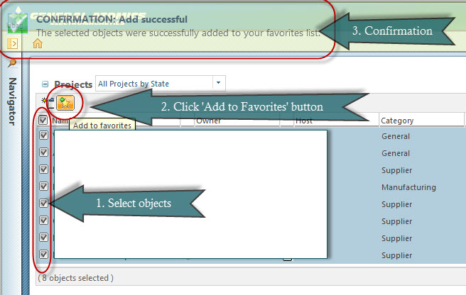

Hello. I have searched in help within Windchill 10 and online but cannot seem to find where my Favorites end up when I follow the fairly simple process as depicted below:
or in ptc's support site: https://www.ptc.com/appserver/cs/view/solution.jsp?n=CS36355
I am in Windchill only, not Creo and would like to know where my favorites end up so I can see them.

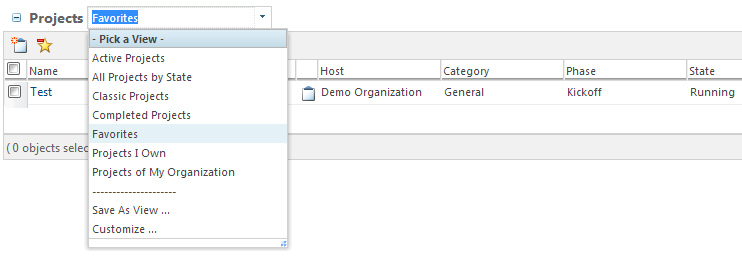

Hi Jeff,

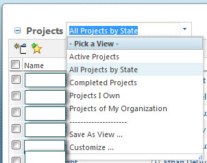

Hmmm... OK, but how do I get the Favorites as a selection in the dropdown?

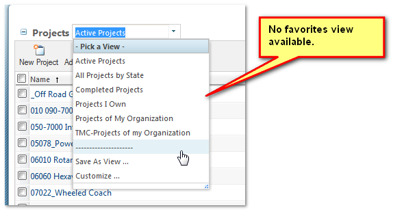

We are seeing the same issue in Windchill 10.1 m040. BUT only in Projects. The favorites view is available in Products, Libraries, and Programs.

This is seems to be a known issue with a workaround.   Contact Tech Support and they should be able to help you.   You may want to reference SPR 2148109 to help speed things up.
In our case they sent a bit of code to load into our server that "fixed" the issue.
