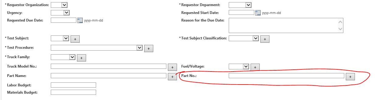

We are trying to link a part to a document instead of typing the part number; we would like to a create a modeled attribute to use a “picker.” We just do not know how to do it. I can’t find any instructions about how to create a modeled attribute. All I have found on modeled attributes is this: “Modeled attributes are programmed in Java and cannot be created using the Type and Attribute Management tool”
We would like to know what we need to do it and how we do it.

You can use a data utility to show a picker. There's a call that a picker with a DataUtility is official not supported, but in my opinion all the API is supported.
https://support.ptc.com/appserver/cs/view/solution.jsp?n=CS198715
PTC is also not sure, because there is an example to show an Organization Picker
https://support.ptc.com/appserver/cs/view/solution.jsp?n=CS80307
And also have a look here:
How to create soft attribute with user picker?
