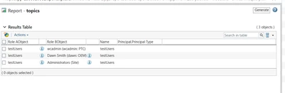

The discussion may have groups or users .
Use attached qml report as start :
