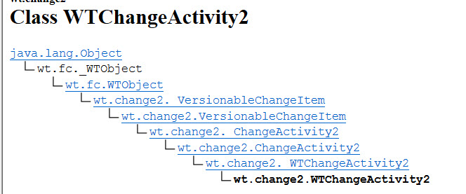

It sounds like the updates did not update your copied Lifecycle and Workflow.  It may be easier to take the OOTB and replicate your Workflow and Lifecycles.  I never worked with WC 8, but I do know that it has been WTChangeActivity2 since 9.1 (if not 9.0).  I'm not sure I could create a ChangeActivity2 if I wanted to.  (If you look at the JavaDoc WTChangeActivity2 is a descendant of ChangeActivity2)
