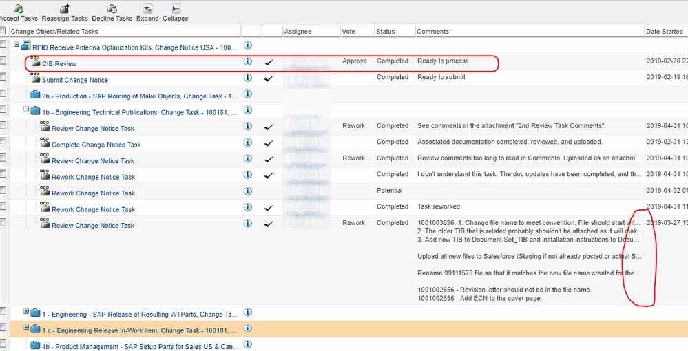

@Dana1
We've been using CIB review to add comments prior to actioning any revisions on Change Tasks.  However those comments have to be pretty short, or they run off the page.  On the attached image you can see a short comment on the CIB task appears, but a longer one on a Change task runs off the screen.   We have (as of yet) found no way to wrap the text in a Change Task (or any Task) comments field.

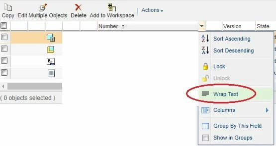

Apr 2, 2019 7:35 PM UTC
In every column you have the Wrap Text option.  Each column header has the drop-down arrow when you put your mouse over it.

@STEVEG
Perfect!  Never noticed this in all the years I've used Windchill! 🙂  Thanks
