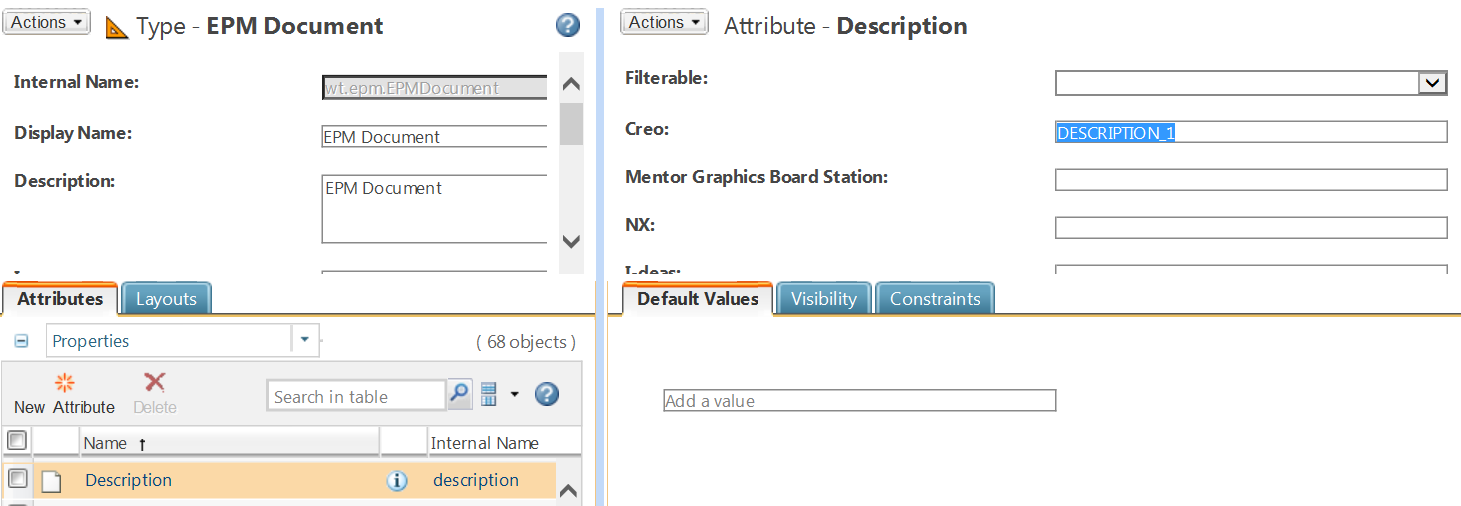

Hi Ashok,
This is different prior to Windchill 10, so my answer is for 10.x and up.  Please let me know if you are using an earlier version.

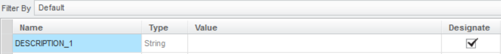

Lets imagine you are mapping description in Windchill to DESCRIPTION_1 parameter in Creo.  In Windchill 10.x it is simple enough whether you are implicitly or explicitly mapping, simply update the "Creo" attribute mapping with the case sensitive name of the parameter as seen in the picture.
Make sure that you "Designate" that parameter in Creo, and it will synchronize to Windchill upon checkin.
If we take this 1 step further, and you would like to synchronize to your wt.part.  The WT.Part must be associated to the Cad object, and the Attribute "description" must have the same name on the WT.Part and on the Windchill EPM Document.  Then it will synch upon the next WT.Part check in.
