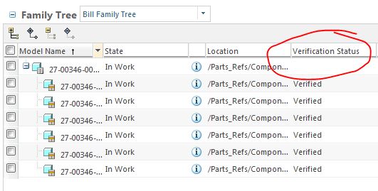

Yes...I've looked through the resource many times!  There is only one report ever created for family tables...but it is missing almost every attribute that I need for the list above.
Still looking for the QML code for this column in the tables.  Tech support hasn't been able to answer it yet and I've asked a couple experts without luck.  I'm starting to hate Windchill UI more and more each day...I bet Teamcenter data model is much easier. They probably have it set up to where a user can drag and drop the column into the query report builder...

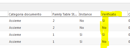

I think you can select "Verified" from EPMDoc table.
What you'll see is Yes or No
Marco
Oct 9, 2015 10:40 AM UTC
If it was only that easy!   The Verified is used in another query report I created to find all the assemblies in our database that will need to be repaired to build WTPart Product Structure.  Reference case CS145803 which is where the picture below came from.  You can associate WTParts against those assemblies in your picture, but try to build...you will see what I mean!  You can also see Verification = no on items where family table status = 0 (which are not family tables)
