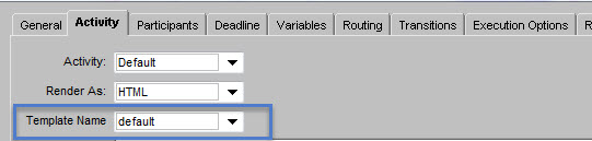

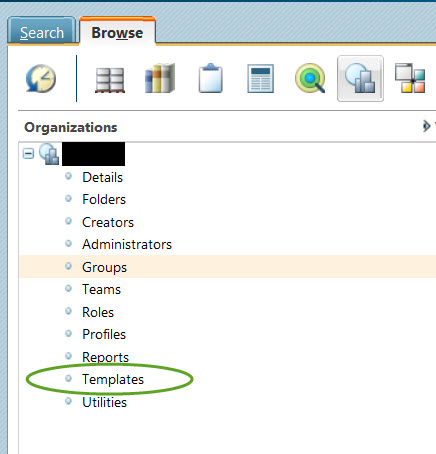

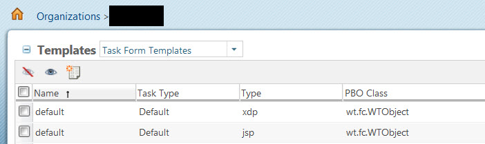

OK - To work with Task Forms you will create/modify a Task Form Template which is a jsp Page.  This gets loaded in tat the Site or Org level and found under Templates (Org shown)
You define which Task Form Template gets used from within a Workflow Assigned Activity Node
There's actually fairly good Help on this in the Help Center: for 10.2 this is Advanced Customization > Business Logic Customization > Customizing Workflow Administration > Customizing Workflow Task Pages although if you're considering an upgrade to WC 10.2 M030+ you may want to look at waiting for the Native Task Form Templates (Native TFT).  See Who has Implemented Native Task Form Templates in 10.2 M030?
