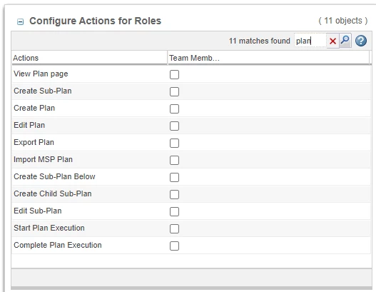

Look at the Configure Actions for Roles capability under Team for the project. You have the following options for all the various Roles.

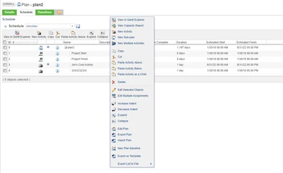

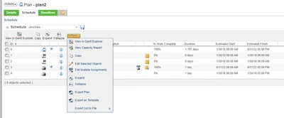

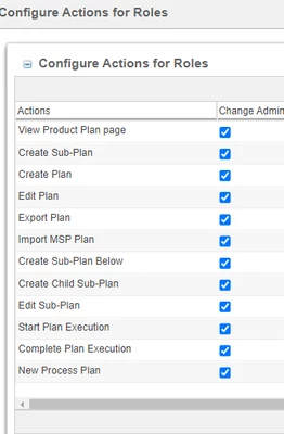

Maybe I am doing something wrong, because this doesn't work for me.... but what can be assigned to someone other than the context owner is severely limited
My settings:
My role Assignment:
What I see:
What the Context Owner sees:
