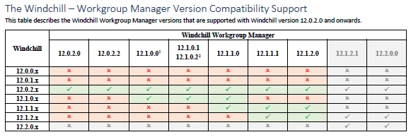

"Windchill Workgroup Manager Software Compatibility Matrix": https://www.ptc.com/en/support/refdoc/Windchill_PDMLink/compatibility/WWGMCompatibilityMatrix
avillanueva
23-Emerald II
Feb 9, 2023 5:16 PM UTC
I can see the confusion in the way this is written. I speaks only of 12.0.2.0 and onwards. I know that the WGM is following its own release cycle loosely tied to Windchill releases. Clearly it says that WGM 12.0.2.0 is NOT supported with Windchill 12.0.0.x. I would therefore recommend sticking with version 12.0.0.1 which is available from the software downloads.
More info: https://www.ptc.com/en/support/article/CS358186
You answer can be found here:
https://www.ptc.com/en/support/article/cs242516?source=ArticleViewerRelated

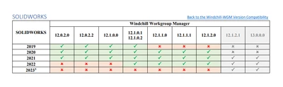

Thanks for your reply, I got that I have to use WGM version 12.0.0.1 for Windchill 12.0.0.0.
But I'm still struggling because WGM 12.0.0.1 is not compatible to Solidworks 2021 version refer to the Matrix (following matrix)
(Our Customer is using Solidworks 2021)
And I figured out that Windchill version and WGM version should be matched.
In this situation, do you have any other recommendation?
