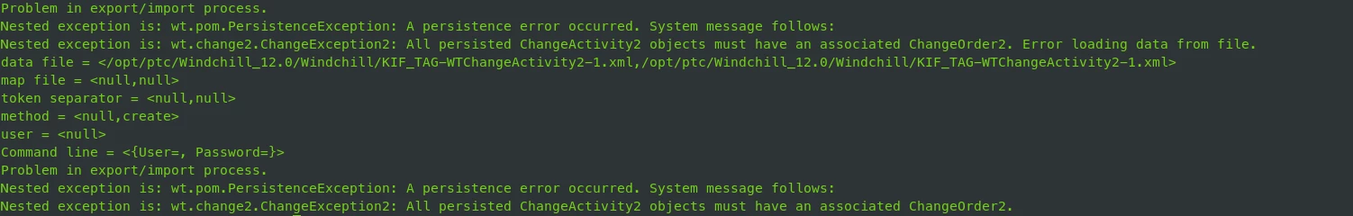

While loading the Change order Template using loadFromUtility getting the below error
I am using Windchill PDMLink Release 12.0 and Datecode with CPS 12.0.0.0

2024-10-15 18:29:28,394 ERROR [RMI TCP Connection(8)-127.0.0.1] wt.method.MethodContextMonitor.contexts.rmi wcadmin - 2024-10-15 18:29:27.477 +0200, m55w6xfougu;m2anrrbe;8402;s03q2u;5, -, -, -, wcadmin, 127.0.0.1, wt.load.StandardLoadService, importData, , 0, 51, 0.05287583, 33, 0.203523442, 0.544559192, 0.916640064 (wt.ixb.publicforhandlers.ixbResource/8) wt.ixb.publicforhandlers.LogHelper$IxbException: Problem in export/import process.
Nested exception is: (wt.pom.pomResource/0) wt.pom.PersistenceException: A persistence error occurred. System message follows:
Nested exception is: wt.change2.ChangeException2: All persisted ChangeActivity2 objects must have an associated ChangeOrder2.

Please provide the question. I can only guess. The key line is this: Nested exception is: wt.change2.ChangeException2: All persisted ChangeActivity2 objects must have an associated ChangeOrder2.
Yes, in order to load a change task, it must have a change notice existing that its linking up to. I have never done an import like you are doing but seeing as its loadFromUtility, I think the order of the elements being loaded is the issue. Change Order First, then change task then the link between the two or it should task you for the change order in that import line.  Can you share details of the CSV or XML version (redact your key information).

So the solution You have provided me on the error likewise I have loaded Change order first then chnage activity but while loading the change activity I am getting the below error

What would help is the source CSV or XML.
