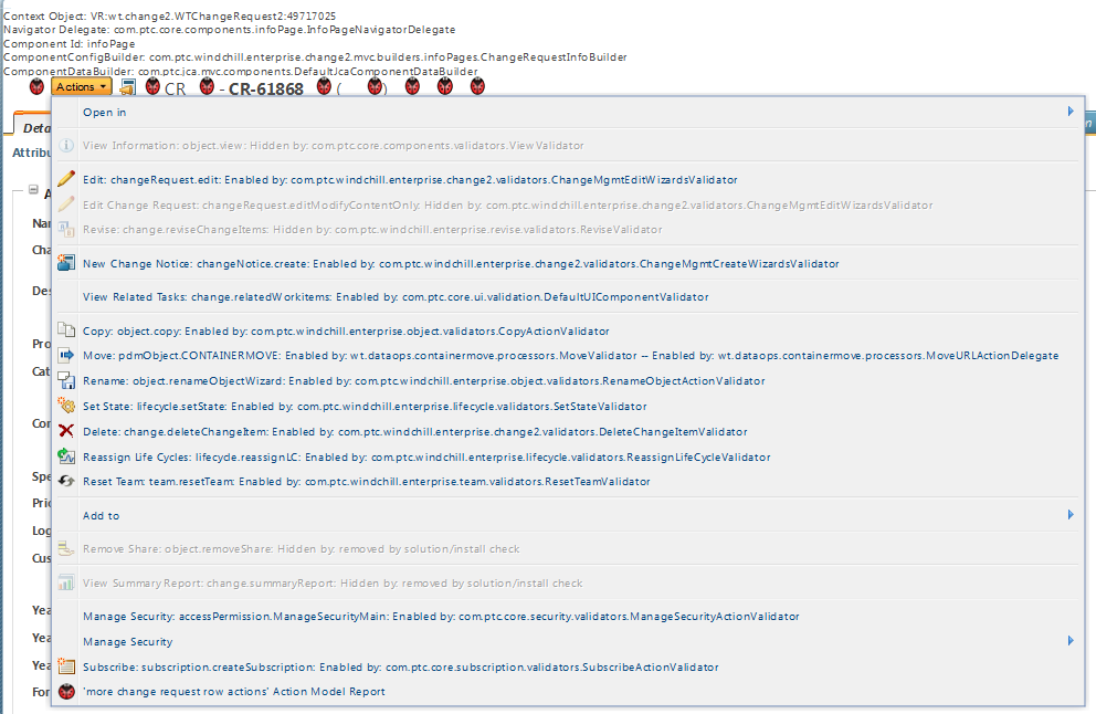

I tried with the Debug but this is the result:
The behaviour is the same for Admin

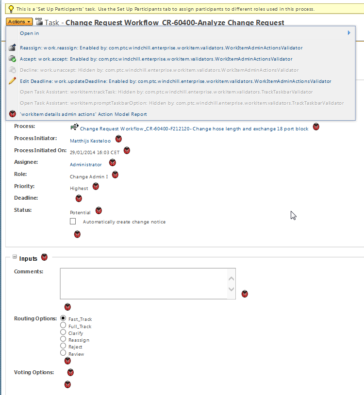

Oct 2, 2015 4:03 PM UTC
I took a look at the code for the TrackTaskbarValidator class. Both of the "Open Task Assistant" actions will be disabled if the Task is not an instance of the WorkItem class, you are not logged in as the owner of the current Task, or if the current Task is complete.
Object type can be determined from the URL:
From your original screenshot it looks like you are logged in as rafaella user, but the task is owned by Administrator.
If you are logged in as Administrator, you are still not able to see the Open Task Assistant for this task?
