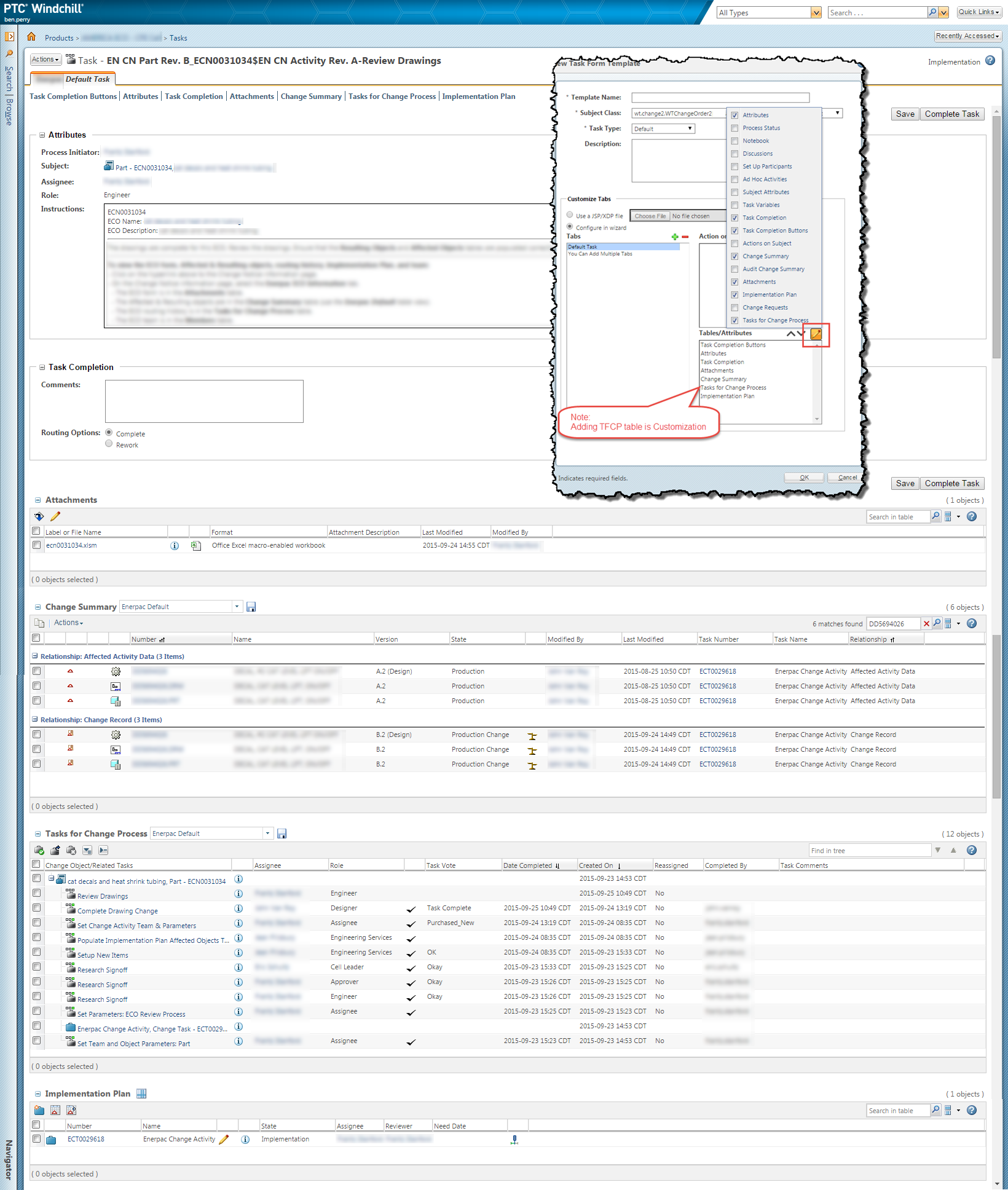

I wanted to share my experiencing implementing the new Native Task Form Templates (Native TFT) that were introduced in 10.2 M030.  The reason I would like to share my experience is because it didn't go as smoothly as I hoped.  But there was nothing show-stopping.  I hope this is a good resource for others looking to implement them.
Please be aware that this example focuses on the Change Notice as the PBO.  But you can create native TFT for any PBO.  For example, if you route WTDocuments, you can create different native TFT for them, and show different PBO tables.
Benefits
PBO information is visible on the same page as the workflow task.
User's don't need to navigate away to other pages to find the most commonly requested information when performing a task.
Users can do things such as view attachments, view CAD in Creo View, add objects to the workspace, etc ... all from the workflow task page.
Keys
  • The native TFT needs to be created.  Navigate to Site (or Org) > Templates.  Choose the "Task Form Template" table view.
  • The workflow templates need to be updated to use the native TFT.
  • The Site (or Org) preference "use task form templates" needs to be set to "yes".
Surprises
  1. I created the native TFT at the end of July, and also updated all of the workflow tasks in all of the Change Notice workflows to use the new templates.  However, even after 2 months, 137 of the 325 open workflows were routed before the end of July.  So when the "use task form templates" preference is changed to yes, the tasks in the 137 old workflows default to the "default" JSP template.
  2. Along the same lines as #1, all tasks from workflows routed from old versions of the workflow template will be subject to this.  So as an admin (or Product Manager), if/when looking back at old workflow tasks that have been completed, it will be rendered with the "default" JSP template.
  3. Because of the previous 2 points, and the fact that I think the OOTB "default" JSP template is ugly, I modified the OOTB "default" JSP template.  I am actually working at org level.  So I downloaded and modified the OOTB template, saved it, and re-imported it at org level.
  4. There are a lot of error messages printed to the MS log whenever someone loads either 1) a workflow task in their browser, or 2) the context's"tasks" page, which lists all of the tasks in the context.  I've reported both of these to PTC and SPRs have been created.  But they have only spent time to fix the messages in Windchill 11.0 at this point, and not fix the messages in 10.2 M030 CPS, since they report the messages are benign and don't affect any functionality.
  5. I was disappointed to find that the Task for Change Process table is not available for inclusion.  Therefore I opened a PTC case and obtained customization to include it.  It looks like it will be included OOTB for Windchill 11.0, however.  CS210836.
Summary
I hope you find this posting helpful.  I am excited about native TFT.  It is a great UI & user experience enhancement.  PBO information used to be below the workflow task in Windchill 9.1.  I'm glad to see it return in the form of these native TFT.  Please find the screenshot below of the finished product, with an overlay of the configurable options for the native TFT.

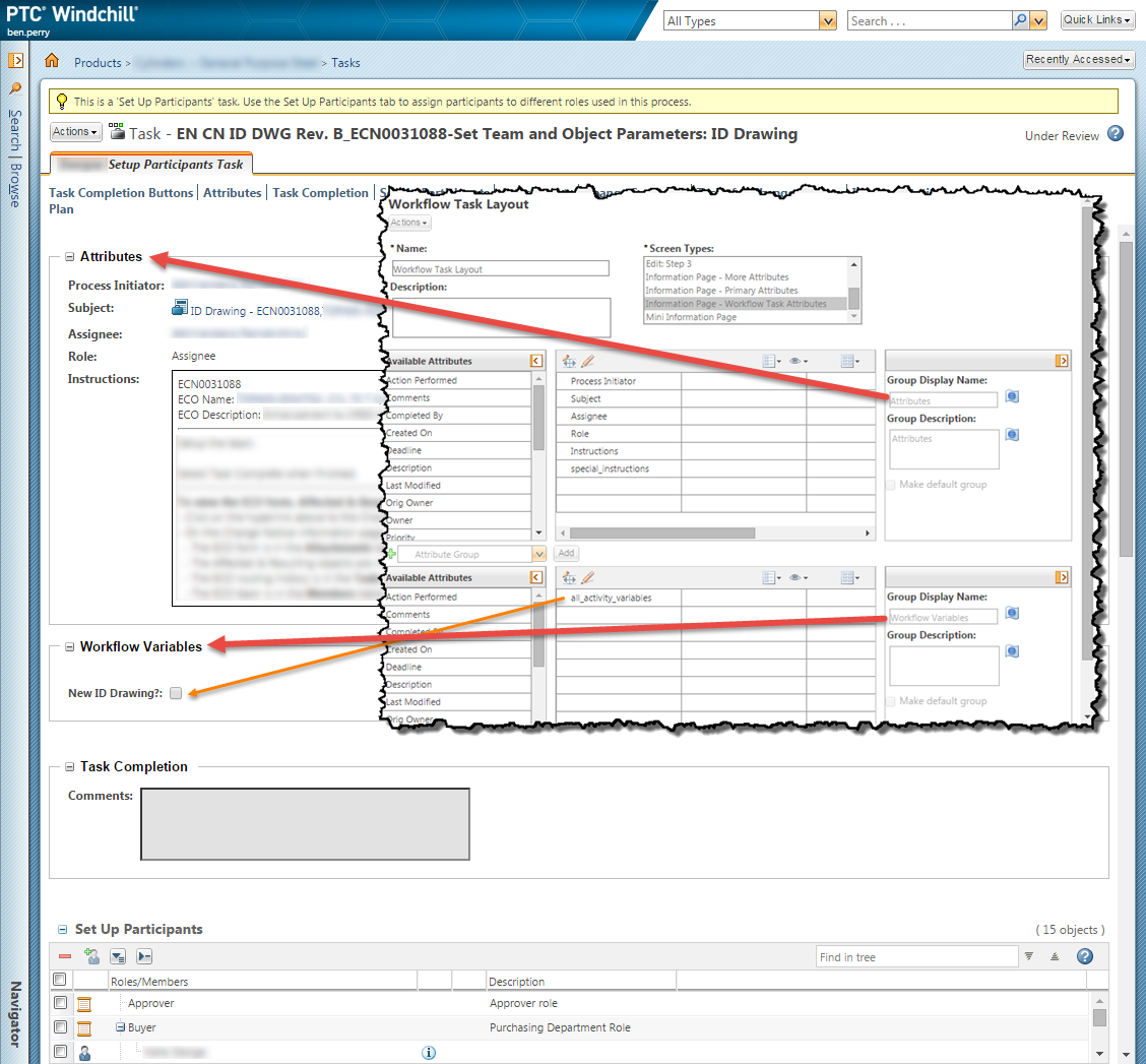

I am very glad you asked that question.  In fact, it reminded me of something I missed in my posting - the layout.
In M030, a new layout was added for the Work Item in Type and Attribute Management.  When you are modifying the workflow activity in the Workflow Template Administration, you need to change the activity to use Native template instead if JSP template.  When the activity's template is set to JSP, then "Task Info Page Layout" will be used.  When the activity's template is set to Native, then the "Workflow Task Layout" will be used.
The above clarification should have been added to my "Keys" section.  But it appears I'm unable to edit my reply.
Now, to answer your question...  Yes, we use a lot of process variables.  The Attributes section of the native TFT.  That section looks at the Workflow Task Layout layout in Type/Attribute Manager.  I've pasted a sample of that below.  I created a separate section just for the process variables.
