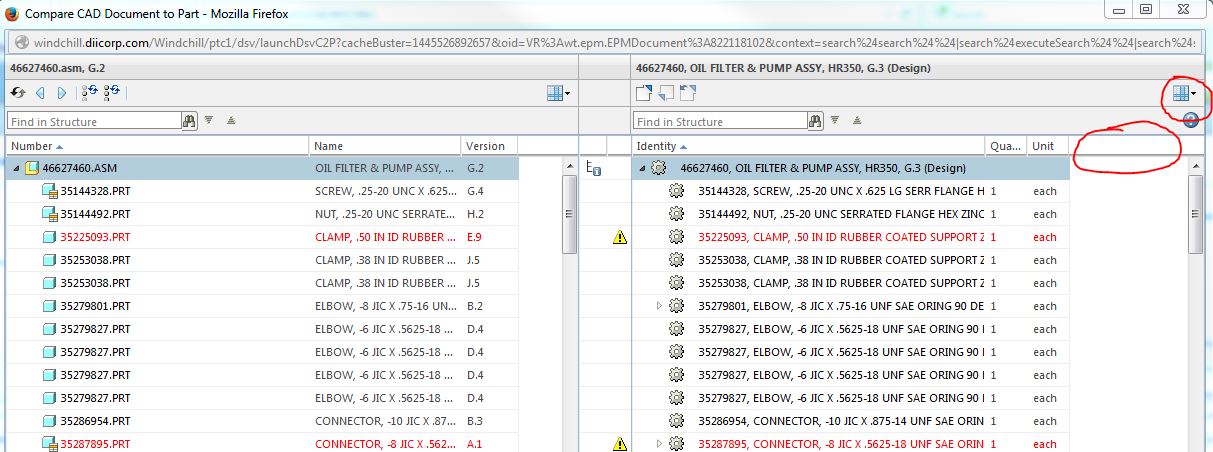

When I run a the Compare CAD Document to Part, it takes at least 30 to 90 minutes to show the results.
The boms that I have tested range from 10 to 30 associated components.
What can cause this? anybody else run into this problem? if so, how was it fixed?

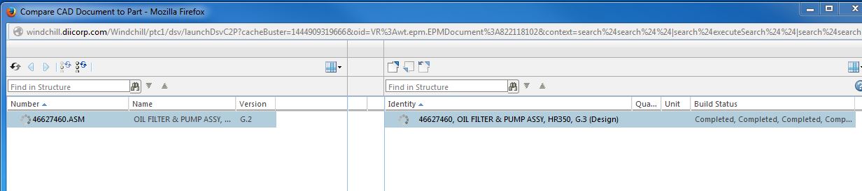

I submitted case to PTC, they had me to remove the "build status" column and it worked, less than 5 seconds.
Jan 27, 2016 12:37 PM UTC
Update, ptc supplied a patch in which that fixed the problem.  I do not have to take the "build status" column per above.
