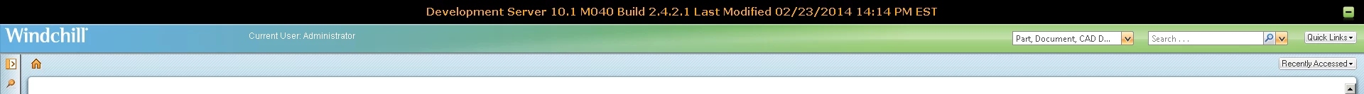

I am posting as a separate thread more details about my customization for a
Banner in 10.1 and 10.2 that extends PTC banner feature described in the
customizer's guide. I am seeking to have PTC work with me to add this out
of the box as part of a future release. I am adding the images posted on
the other thread here also.
I have developed a series of preferences to allow the banner to do the
following:
- Allow banner message to be updated by a preference, when updated (but out
of sight), banner will reappear to broadcast new message
- Specify the height of the banner without losing OOTB functionality of the
UI
- Allow font, font size, font color of message to be adjusted
- Allow background color of banner to be adjusted as well as what color
appears behind the Windchill logo
- Specify a different logo instead of the default ones provided by PTC

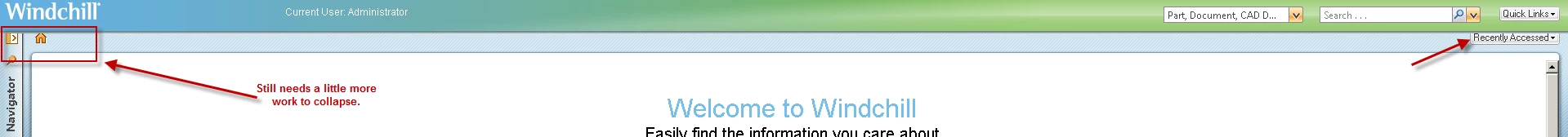

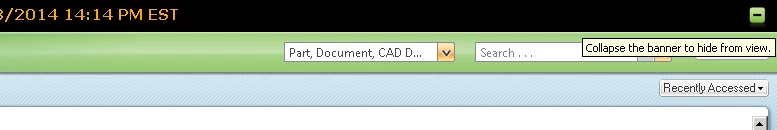

- Allow collapse of the banner
- Enable automatic collapse of the banner
- Specify what icon is to be used for the collapse banner icon
- Enable an external content file to be loaded instead of the message stored
in the preference string
- Disabling the banner functionality entirely
