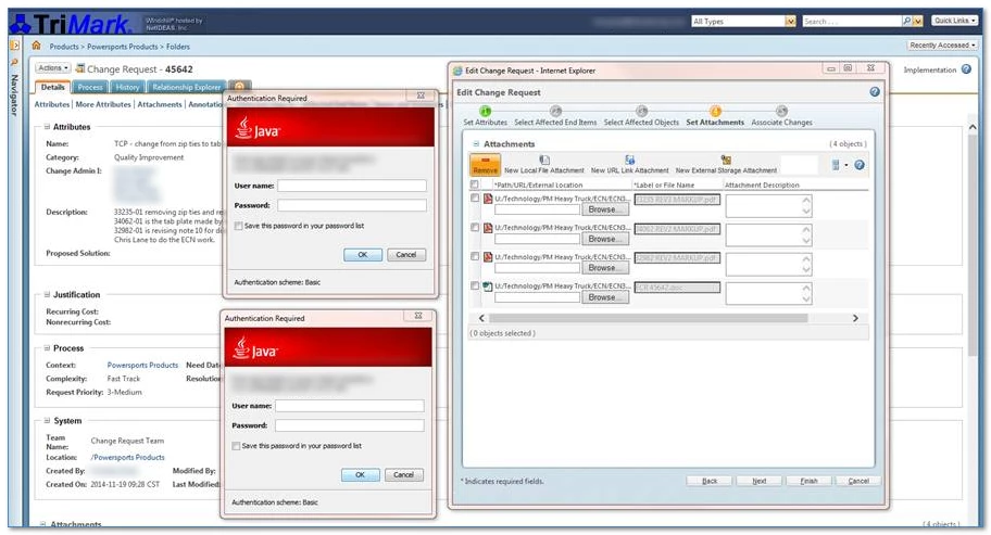

Hey,
We have had to install and upgrade IE and Java past the officially supported versions for security reasons, so I am not surprised by this happening, but am wondering if there is a workaround?
-marc

On 11/25/14 09:38, Marc DeBower wrote:
> Hey,
> Several of our people are experiencing multiple Java log on windows when using Windchill. They
> regularly see 2 or sometimes 3 log on windows appear in short order, one after the other. This is
> before they even enter in their user id and password. (See screenshot.)
One possible workaround is to set the Windchill "File Upload Mechanism" preference to "Use basic
browser functionality to select and upload files". The default is "Use Java applet functionality to
> Windchill 10.1 m040
> IE 11.0.9600.17358
> Java version 8 update 25 build 1.8.0_25-b18
